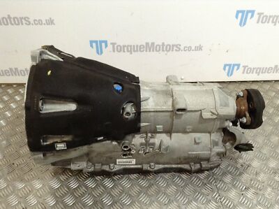

Ive made a topic on this before but cant find it, but ive noticed it again lately.
Sports plus usually, sometimes traction mode, moderate throttle, 2nd to 3rd gear almost seems to slip like a manual would if the clutch is gone, wheels dont feel like they are spinning at all. The revs seem to jump as the gear changes until the speed catches up it seems then it continues revving high as the car speeds up. Usually the wheels spin before traction control kicks in because i didnt know if it was that but the wheels dont feel to spin at all.
Is this a normal zf8 trait, if not what could be wrong? Its not logging any fault codes and XHP have said they cant see any issues when i sent a log before. It just seems to happen quite often, usually seems to be 2nd to 3rd under moderate throttle (not full throttle weirdly).
Genuinely concerned there is something wrong with the box but theres no noises or anything.

Right its 100% percent slipping from 2nd to 3rd gear at medium throttle, jumps about 400rpm.
Any idea of possibilities at all? Looking at a new box arent i? 😔

So ive had a reply from ZF. They are suggesting due to the quickcharge pressures all being negative it could potentially be the clutch discs are swollen which could be caused by coolant leaking into the transmission via the oil cooler.
Obviously thats not for certain but im having slow coolant loss aswell, could all be linked!! If thats the fault the modifications have had zero impact on it happening its just bad luck.
Now to decide who on earth can check this for me.
