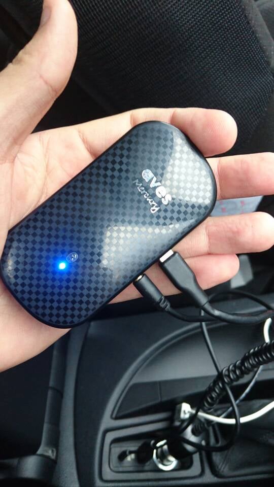

First of all, I purchased this: Aves Mercury Bluetooth Wireless Stereo Audio Receiver w/ 3.5mm Jack For Speakers At only ÂŁ9.99, it's seemed worth a punt.
It arrived this morning, a very small, neat and quality looking device for the price. It comes with everything you will need, apart from a USB cable (luckily, I had several of those lying around anyway)

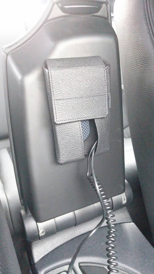

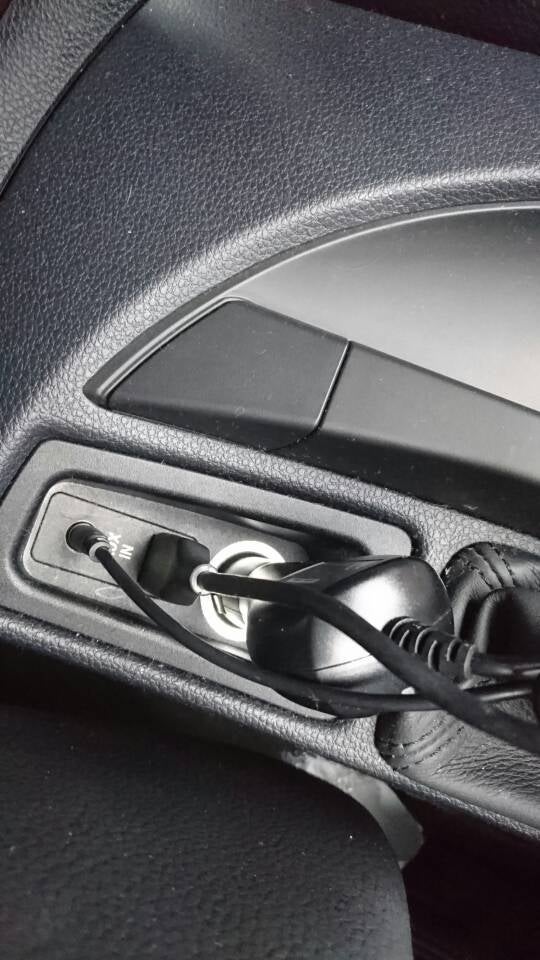

I plugged it in to the Aux and USB port under my armrest and found a lovely little home for the device in the leather pocket under the armrest (if you have one of those)

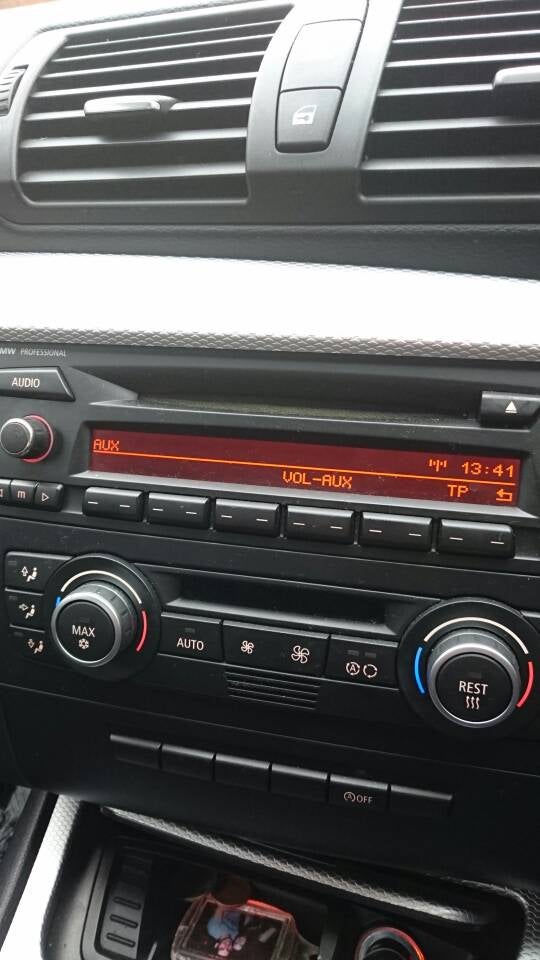

I synced the Bluetooth receiver to my Xperia Z3+ phone and played my music from Spotify. The quality is excellent, playback is instant and it's all very seamless. Most importantly, because this device doesn't have a built-in microphone (as some of them do), when you make or receive a call, it drops back to your in-car Bluetooth for the call... Winner!
The only 'issue' is, that because your car thinks that it is just an Aux input, there is still no functionality to skip track through the steering wheel/head unit.
Also, the USB under the armrest seems to always be powered, even when the car ignition is off, so I'll have to watch out for battery drain.
