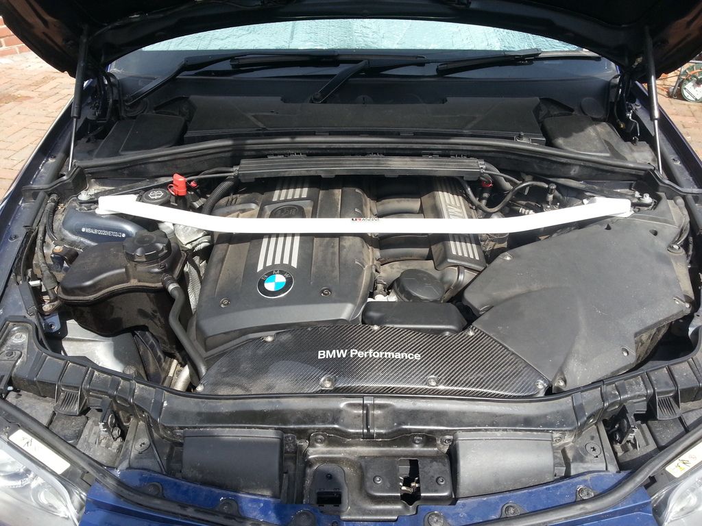

Air Intake
This is a pretty expensive mod for the gains I think. It looks great in the engine bay with the carbon duct and does sound slightly better than the standard intake. I fitted the intake a month or two before the back box and remap and never really felt much change in the way the engine drove. I think if I had the choice again I would just buy the BMWP filter and fit it to the standard air box. I think this would get 90% of the improvement with 1/5 of the cost.

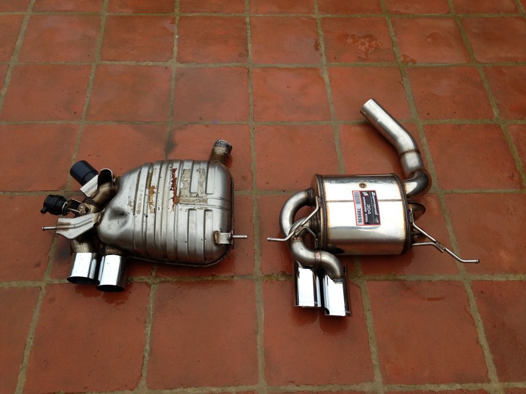

BMWP back box
This is again a mod I would highly recommend. The BMWP back box stainless steel tips look so much better and the sound is subtly improved over the standard back box. This sound improves over about 1k to 2k miles to give a deeper, richer exhaust note that adds to the drama on a drive. There is slightly more drone at 70mph in 6th but not enough to detract from the benefit during A and B road driving. I think that any performance gains are so negligible that it is not possible to notice (the back box was fitted a few weeks before the remap).

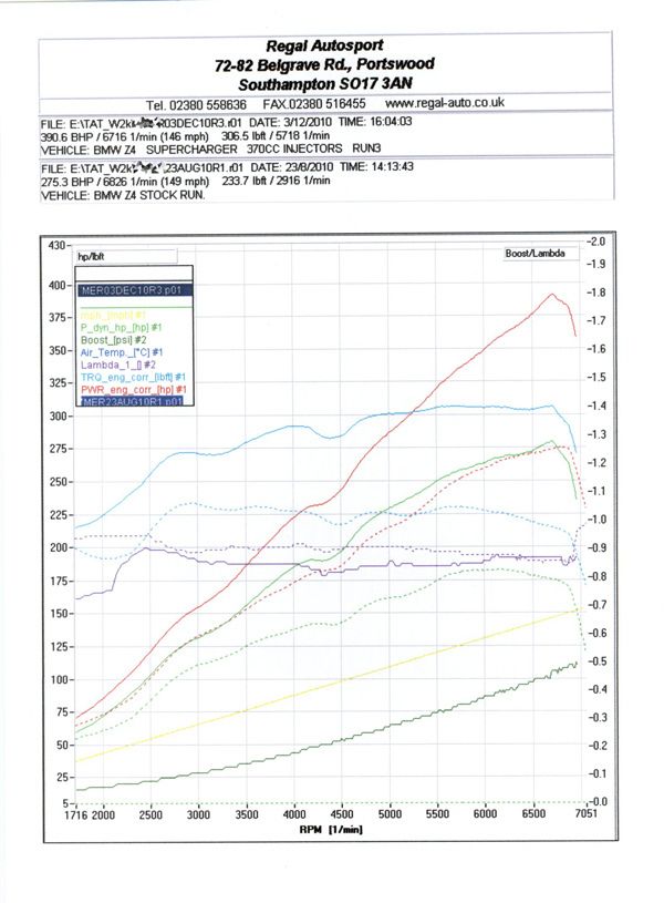

At the end of 2012 I had seen an article in Total BMW where Regal Autosport in Southampton had customised an E46 330i Vortech supercharger kit to run on a BMW Z4 3.0si with the N52 engine. The kit was pushing out 390bhp (without headers). I contacted them for a quote to fit this kit to my car. The price was reasonable but soon after I started discussions I found a house to buy, I had to spend my spare funds on a house deposit and various white goods!! Whilst in talks with Regal they mentioned that in order to make the SC kit more efficient and have less issues they would recommend fitting sports cats at the same time. Apparently OEM cats in the headers don't take long to disintegrate from the additional heat and air flow. It seems this is fairly common with most of the aftermarket supercharger kits but not mentioned on AA, ESS, VF etc websites! My shopping list had grown to include suspension set up, diff, brakes, headers/cats and an SC kit!
Z4 N52 Dyno - stock car had Remus cat back exhaust hence 275bhp base power:

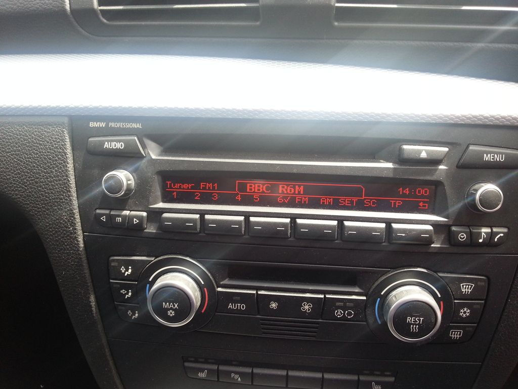

At the start of 2014 in order to keep tinkering I replaced the Business head unit with a Professional head unit from a facelift 3 series which had the inbuilt Bluetooth, DAB, USB and AUX. I didn't want the hassle and added weight of retro fitting the MULF unit in the boot with the older units so this was an unplanned find on eBay I jumped at! With the new HU I had to replace the roof aerial with a DAB and FM aerial so chose a Kinetic DAB stubby aerial. The whole retro fit was pretty easy, the hardest part being the Kinetic aerial didn't have a FAKRA connector on it!

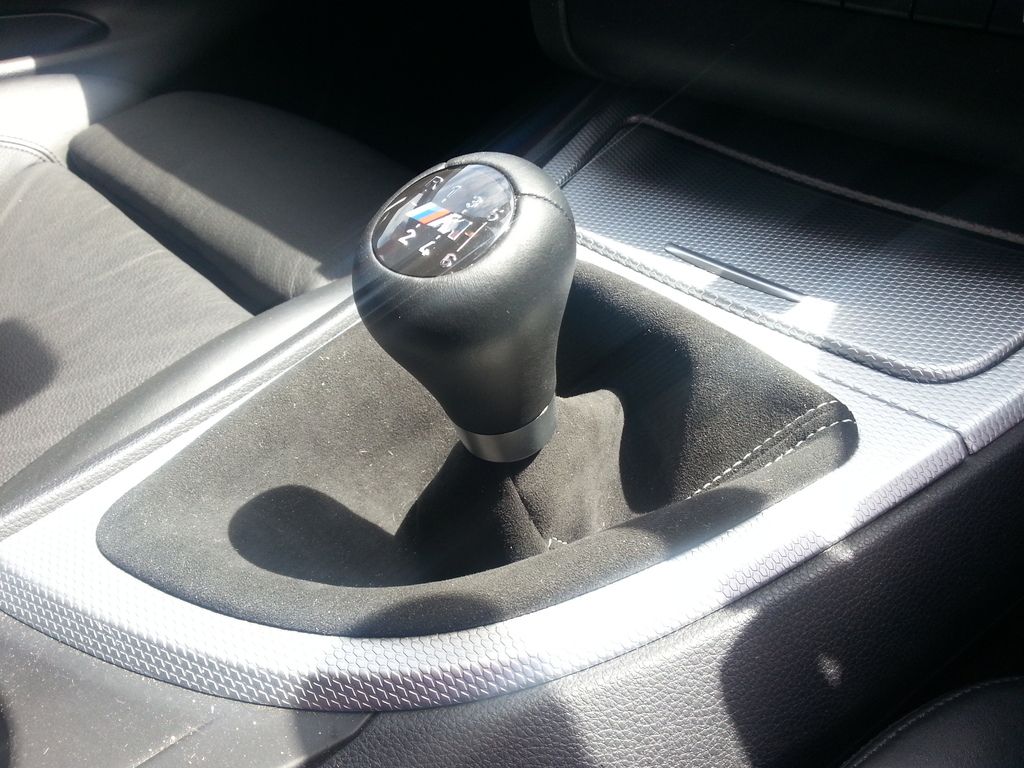

After the B1 kit and whilst saving for manifolds and cats I was given BMWP aluminium pedals from my girlfriend. These look good but also help heal and toeing. As the rubber is only on the top of the pedal it is easier to slide the side of your foot off the pedal and the raised height of the brake pedal over the accelerator seems to make it easier on slower corners when you are not braking and reving so hard. Again I would recommend, they improve how tactile the car is, it's not just an aesthetic improvement like I often thought they were!

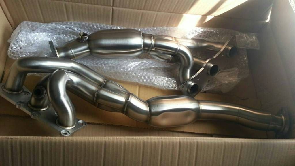

This summer, having bought all of the exhaust components over a 9 month period, I got them fitted. I had bought Supersprint sports cats, Supersprint unresonated centre section and ARMA headers. The ARMA headers I had got coated in Zircotec ceramic coating. ARMA were the only people offering off the shelf RHD headers and having contacted Evolve, Supersprint and other custom exhaust manufacturers I could tell there was no appetite in the UK to make a custom RHD header for the 130 and some of the quotes were insane…£3+k just for the headers! Anyhow having received the ARMA headers I would say the quality of the welds and design seems as good and maybe even better than that of the Supersprint items I bought. I think people in the BMW modified world are very snobbish when it comes to new manufacturers in the market or parts from outside Europe or the USA. I had the headers Zircotec coated to reduce engine bay temps once the supercharger is fitted. I thought this would help the longevity of any parts near the manifolds and may reduce the need for oil coolers or upgraded radiators in the future. My original plan was to fit the headers and Supersprint parts to the BMWP back box….however this changed when the garage I'd entrusted the work to f*cked the job up ( " onclick="window.open(this.href);return false; ). Anyhow it all got resolved after a lot of stress and hassle. I therefore bought a Supersprint back box to replace the BMWP back box so that the connection between the mids and back box was plug and play. According to the garage the headers, cats and mid section all fitted easily. The time consuming work was extending the O2/Lambda sensors.
ARMA Zircotec coated headers, Supersprint cats, unresonated centre section and back box
All parts have been fitted to the car for a couple of months now. Running an NA set up the sound is different to the OEM exhaust and BMWP back box. In my opinion it is better but the difference is subtle, not massively different even with non resonated mid section. I think the car feels like it is keener to rev, especially towards the top end and the exhaust note above 4k revs is very good! I (think) there is more power available, from the butt dyno I reckon it must be 10bhp plus at the top end. It will be interesting when I get the SC fitted and the car is dynoed whether this is the case. I am really enjoying the car with this exhaust set up but I wouldn't recommend it if you're not planning to supercharge, it is very expensive bhp/£!! The Supersprint back box tips look even better than the BMWP back box tips in my opinion. I weighed the full OEM exhaust and the Supersprint/ARMA set up….32.5kg versus 30.9kg, not sure how aftermarket manufacturers claim savings of 25kgs on M3/M5 exhausts?! Even made of titanium you couldn't get half of those reductions on a 130 exhaust. I know the M3 exhausts on the E92 have twin pipes and twin silencers but 25kgs seems very optimistic (anyone have an answer?). Most of the savings in my set up were from the back box. Even though the rest of the Supersprint exhaust is a better quality stainless steel to OEM the diameter of the tubing is increased offsetting some of the weight reductions from the better material.

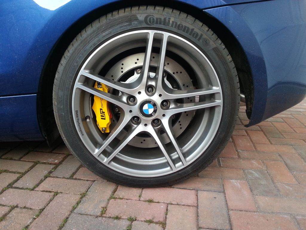

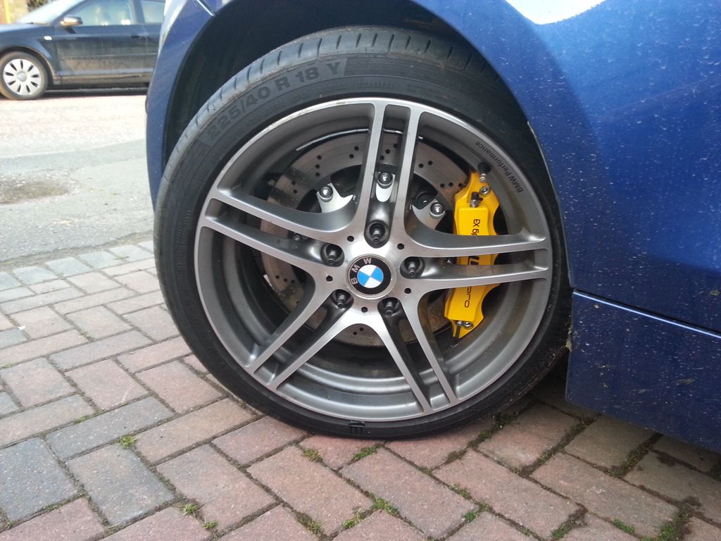

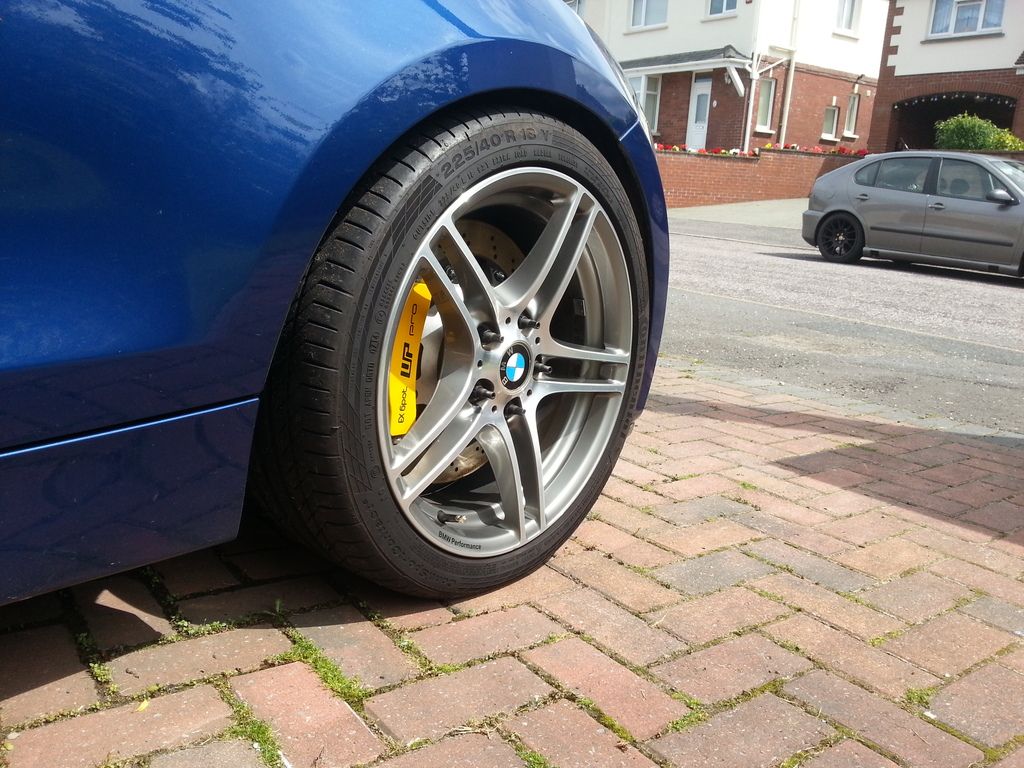

Next mod was to fit bigger brakes! I decided not to go the BMWP brake route as I didn't think they would give that much of an upgrade over the 130's single piston callipers. I toyed with Stoptech 6 piston fronts and 4 piston rears but eventually bought WP 6 piston and 4 piston callipers with 360mm vented and drilled discs. I went with the WP set up as a couple of guys in BMW Performance magazine have been tracking them on an E46 M3 and a converted/custom E36 touring M3. Both the guys are really happy with the performance and look of the kits. I bought them in November 2014 when there was a Black Friday sale knocking 25% off them which made them significantly cheaper than an equivalent Stoptech kit! The kit comes with the rotors, callipers, braided brake lines and all mounting components. For information the full OEM 130 set up weighs 49.5kgs the WP kit with 360mm rotors and 6 piston callipers only weighs 46kgs. I fitted the kit with some Motul RBF 600 racing brake fluid and also converted the wheel nuts to studs and fitted 15mm front spacers and 18mm rear spacers. I changed to studs for practicality rather than aesthetics, as there is so little space between the disc and wheel I was worried I would damage the alloys changing the wheels without the studs!! I don't really have a preference either way over the OEM nuts or the studs. I know stud conversions are a bit of a Marmite choice for some people.
WP Big brake kit
The kit has been on the car a month or two. I have not really used them in anger so can not comment too much on the performance (I will update this once I have more of an opinion). The kit fitted onto the car with no hassles, plug and play. This was the first 130i kit WP had made as the hatch isn't available in North America. WP therefore had to obtain the 130 rear hubs and handbrake shoes to make a custom rear hat for me. Again the rears fitted perfectly first time and the handbrake still works as it should which seems to be one of the issues with a lot of BBKs. I have had some issues with WP customer service but will not add any more comments to this until it is resolved. The WP team are really nice guys to deal with but everything takes an age to happen!!
Fronts
Rears

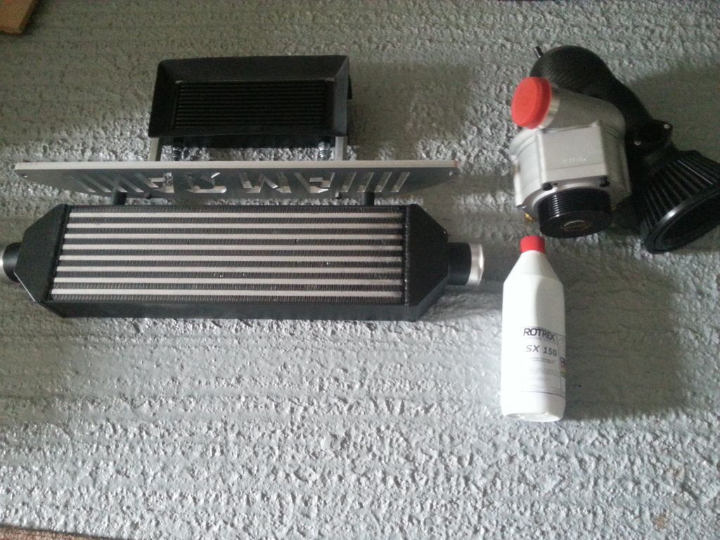

I have the supercharger booked in to be fitted at Regal in the second week in August!! I am having the Rotrex kit fitted and then a custom map rather than using the ARMA piggy back ECU. I have also asked Regal to upgrade any parts they think can be improved upon such as the injectors to get the most reliable, smooth power as possible. I am not looking for crazy numbers, I would rather reliability but I am hoping the kit with the headers will give at least 380bhp which is far more than you can really use on the street!

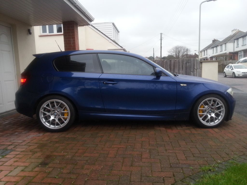

I got the Apex wheels fitted on Wednesday 27th Jan. Took a photo yesterday, not the best photo as its pretty dark and wet but that isn't going to change for the foreseeable future!! So what do people think compared to the 313's? I really like them but still getting used to them. I love the 313s and how minimal the design is. You could really see into them and see the with of the wheel which I thought look really aggressive. These wheels are an inch wider front and rear but yet from the side look narrower. The 255 rear Conti's actually looked slightly stretched on them! I think I will have to go up to a 235 front and at least a 265 at the rear when I next replace the tyres. They are a few kgs lighter a wheel though and give about 10mm extra clearance for the brake discs and callipers.
