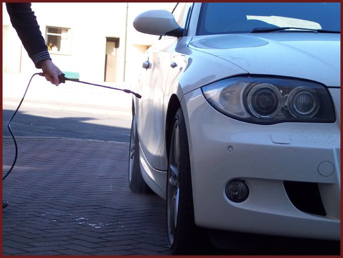

The car was then pressure rinsed, prior to foaming.
HD Lance with a mix of SSF and CG Maxi Suds was then applied.

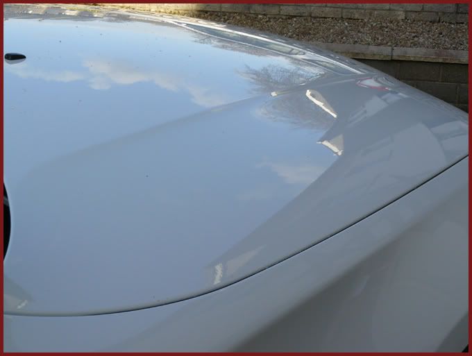

So, after approx 6 hours work, the car ended up like this:
