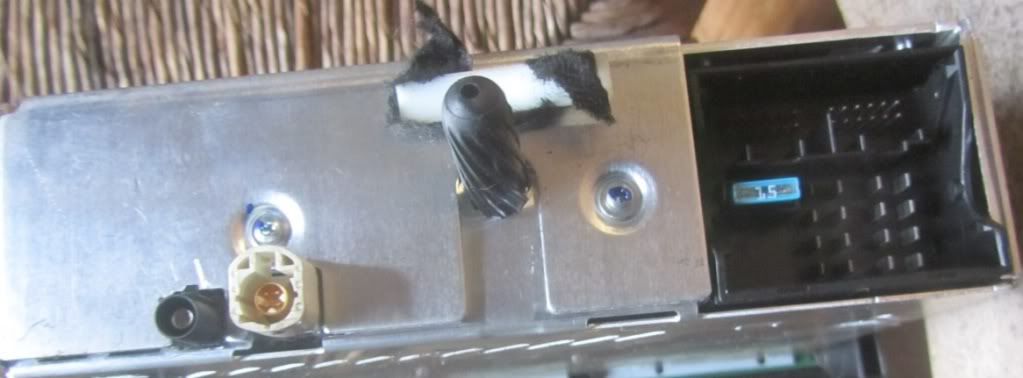

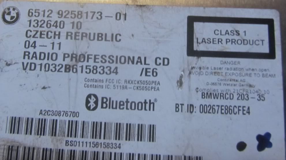

My new pro HU came with bluetooth, I can connect my phone look through the phone book etc and can hear all the calls, I dont have a Mic and can't find the part number needed, could anybody help?
This is my pro HU

OEM BMW microphone 84 31 6 938 762
I made a 3.5mm connector
this end connects to the microphone
removed the cover
Installed the mic
then connected them together
I now have a fully working mic with my Pro HU with builtin Bluetooth

Thanks for posting this, very helpful. I have the same setup, with pro headunit with built in bluetooth. I've got the part from a bmw specialist garage, and found it has no wires or connectors, just the microphone. I can get wires, but can someone tell me where to get connectors that will clip into the microphone and the quadlock connector (mainly the white clip in the second picture) . I'm not really keen on soldering directly to the pins.

Sorry for the late reply I've been really busy (moving house) here are the BMW OEM part numbers
Socket Housing : 61138384550
Covering Cap : 61138387206
Current:
