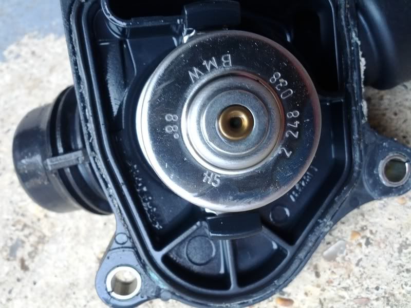

The thermostat is rated at 88 degrees, so it has failed open as it's designed to, which means the DDE thinks the engine is still in warm up mode all the time so pumps in more fuel. (At least that's how I understand it!)

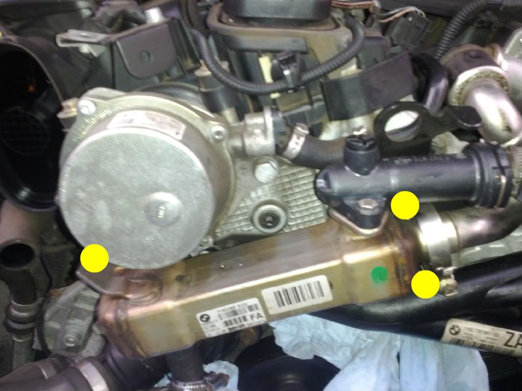

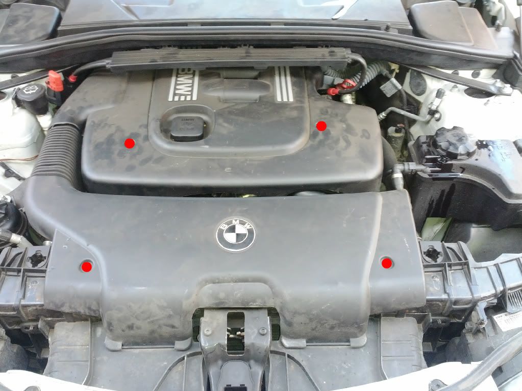

2. Remove engine accoustic cover - 2 x 5mm allen bolts, and slide it forward towards you, also remove front air guide, 2 x T20 screws. See red dots below!
3. Unplug electric fan connector (Shown in green), 1 x T20 bold at the top L/H side of the fan as you look at it, (Shown in red) and there is a little plastic catch half way down on the R/H side you need to hold open as you slide the fan upwards (Shown in yellow).

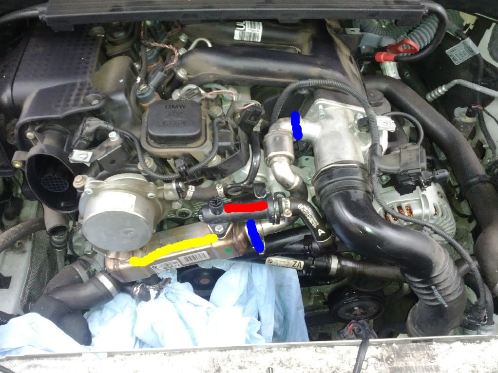

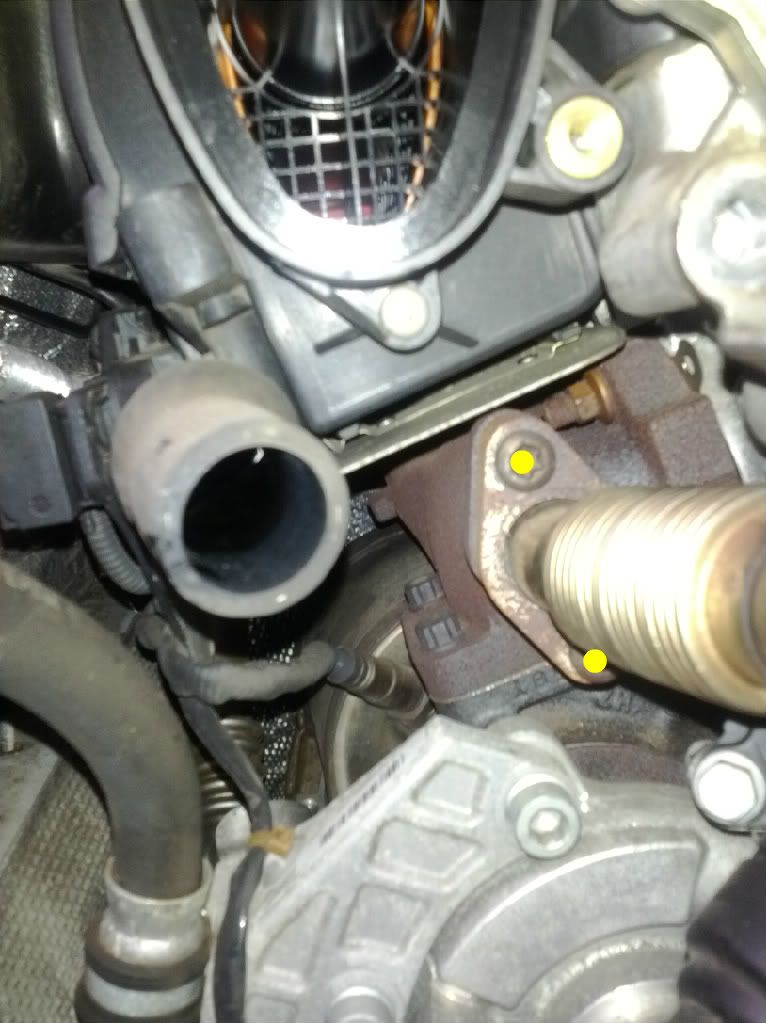

5. Next, because BMW hide the main thermostat behind the EGR cooler, to remove the stat you first have to remove the EGR cooler. First, undo and remove the two jubilee clips that hold the ERG exhaust pipe on. Shown on the pic below in blue, EGR cooler is yellow and EGR thermostat is red.
Then remove the EGR exhaust pipe, to make this easier to remove, unplug the EGR air feed.

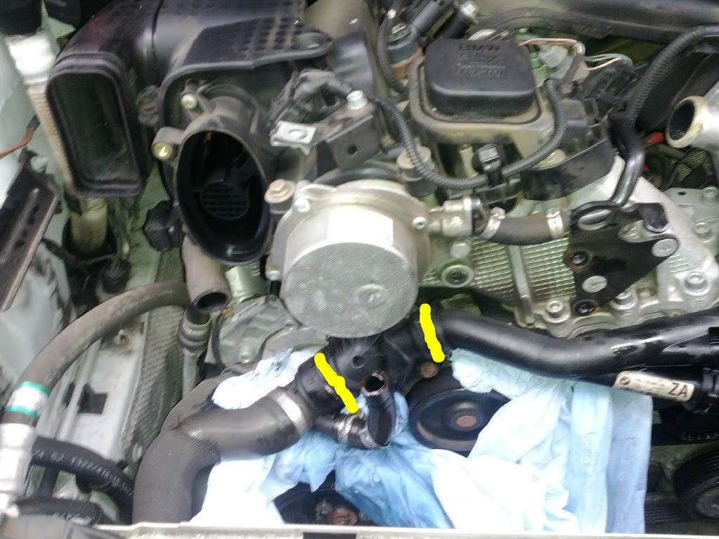

Here is where it starts to get wet, so to try and minimise this I packed the engine bay with blue roll and bunged up the exposed turbo air feed, as you can see above.
6. Disconnect the coolant inlet pipe that feeds the ERG thermostat and outlet pipe (jubilee clip) and remove the hoses. Let the blue stuff flow! Clips shown in yellow below. Also remove the 10mm nut that secures the coolant hose to the block, shown in green.

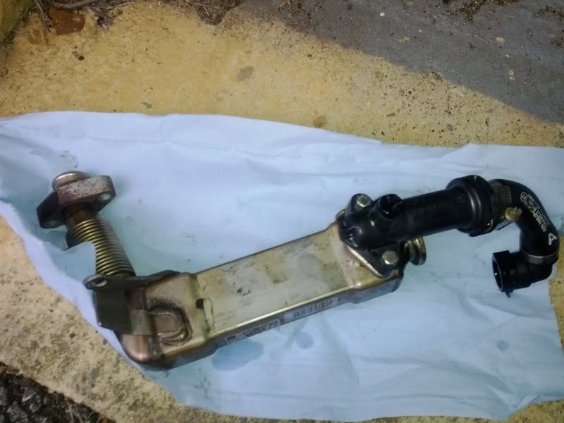

8. Remove 3 x H5 bolts that attach the EGR cooler to the front of the engine, and remove the EGR cooler with EGR thermostat attached.
9. Once EGR cooler is removed, undo 2 bolts that attach the thermostat to it and replace the EGR thermostat for the new one, remember to fit the new 'O' ring that comes with it.

11. Remove the 4 x 10mm bolts that attach the thermostat to the waterpump, remove thermostat and install replacement item!

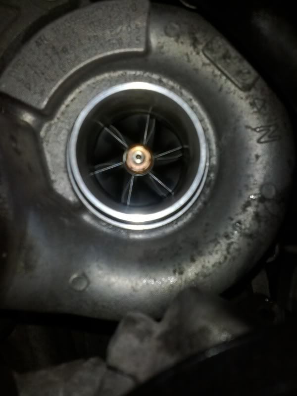

Whilst the access was good I had a feel of the turbo and checked for play, there was none, 60k and it feels fine.

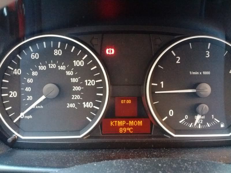

Took it out for a run and checked the coolant temp after a few miles.
It wasn't going past 85 previously, so hopefully that will be the fault fixed. I'll report back with an update to fuel consunption. Also, for a laugh, I'm going to phone BMW for a quote to do the above work. Place your bets now please!
